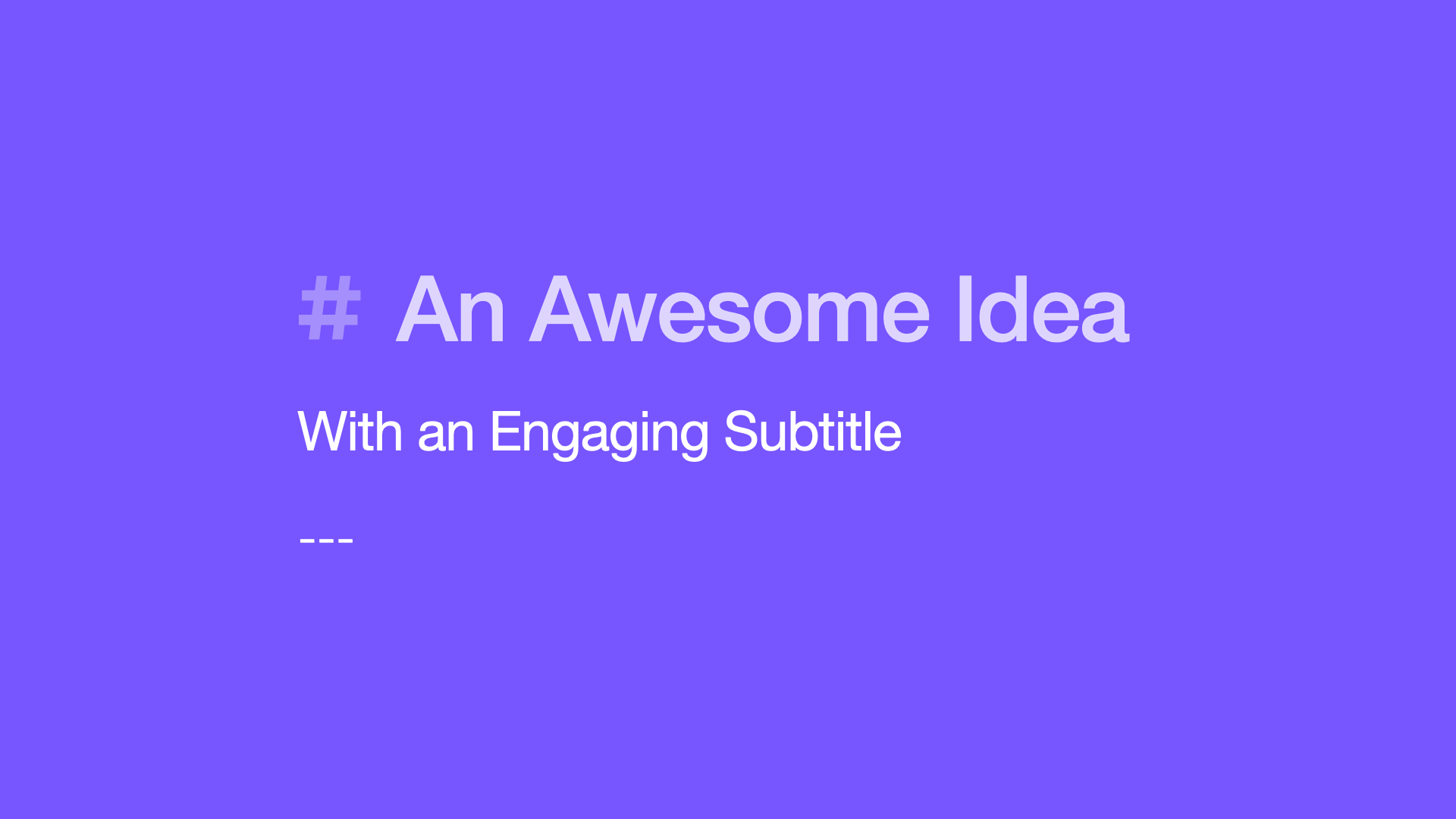

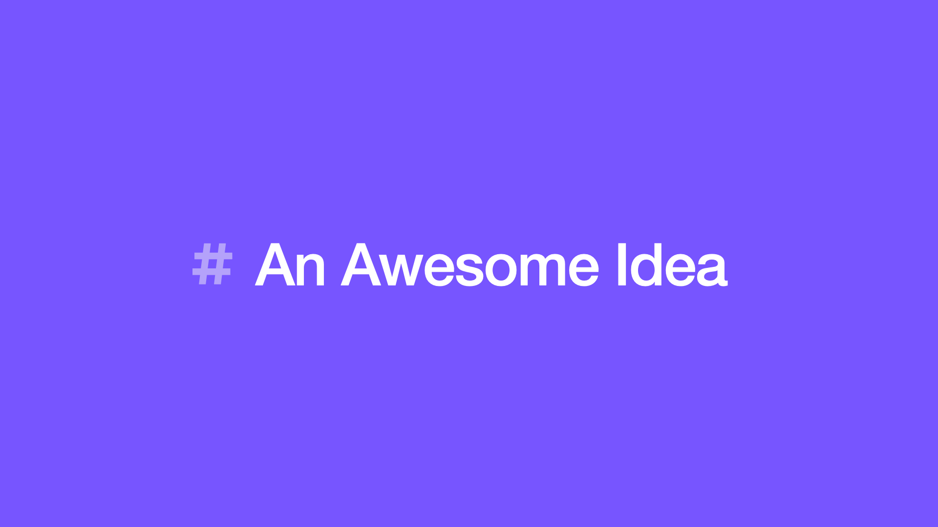

An H1 Title element in Markdown
You don't need anything special to write Markdown: it's just plain text. Start with a hash mark and a space to make a Title. A single hash mark indicates a Title or Divider slide.
A complete Title slide in Markdown
Hit Return, and then add a blank line: then add a Subtitle, and three dashes to indicate the end of the slide. This is all Composer needs to understand that you want to build a "Title" slide.

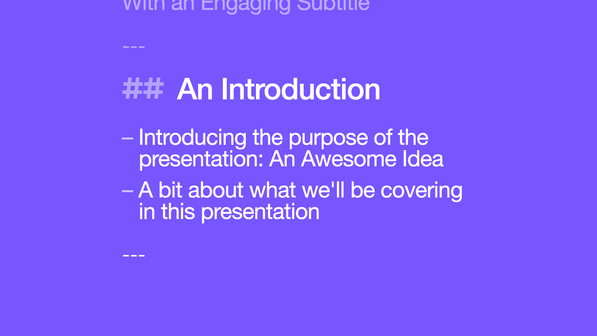

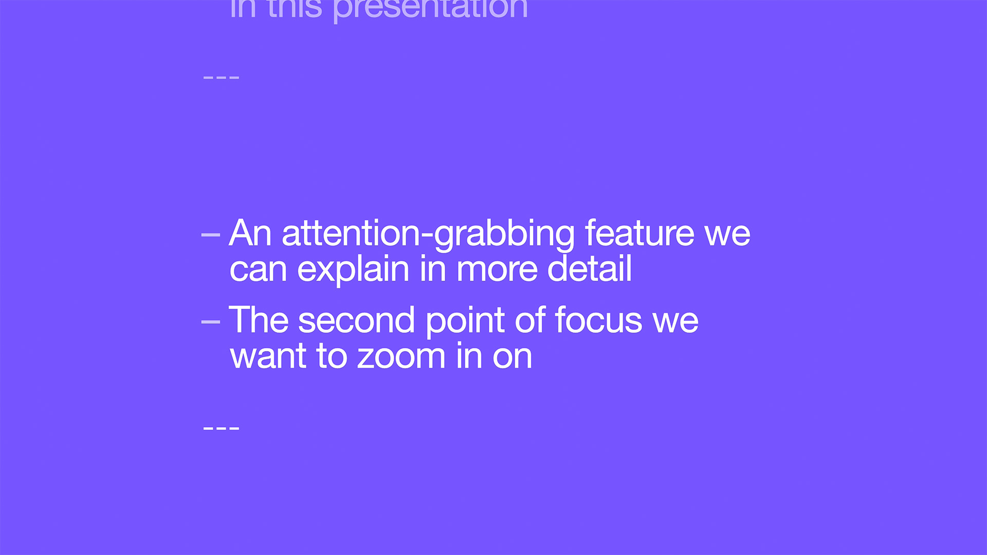

A complete Title and Bullets slide in Markdown
Use two hash marks on a Title to indicate a common Content layout, like "Title and Bullets." To add Bullets, just add a dash and a space to the beginning of each paragraph. When you're done, end the slide with three dashes - just like before.
A basic Bullets slide in Markdown
Composer maps out the basic elements used on each slide against Keynote's default layouts to determine which layout to use. So if we remove the Title from a "Title & Bullets" slide, we're building a basic "Bullets" slide.

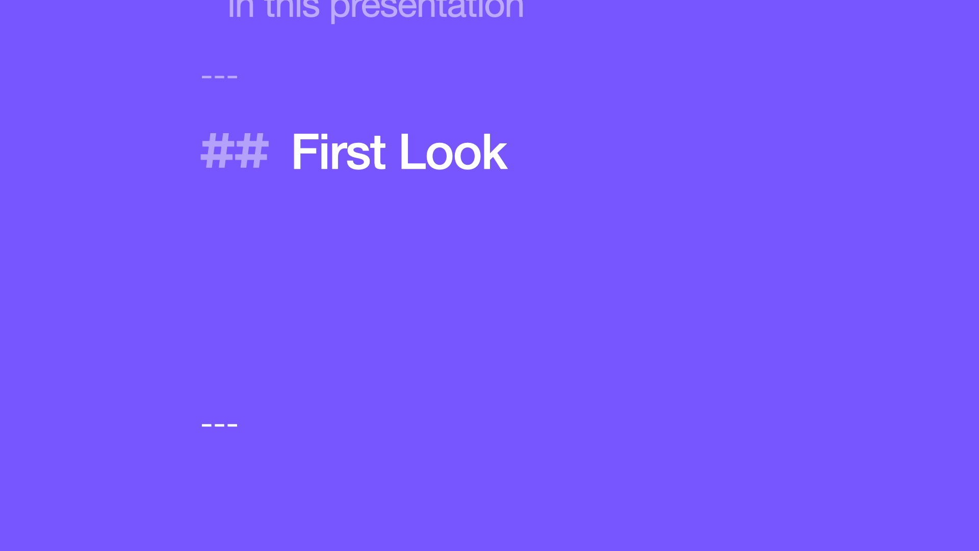

A Title Only slide in Markdown
If we flip that around, and include an H2 Content Title by itself - we'll build a "Title Only" slide.

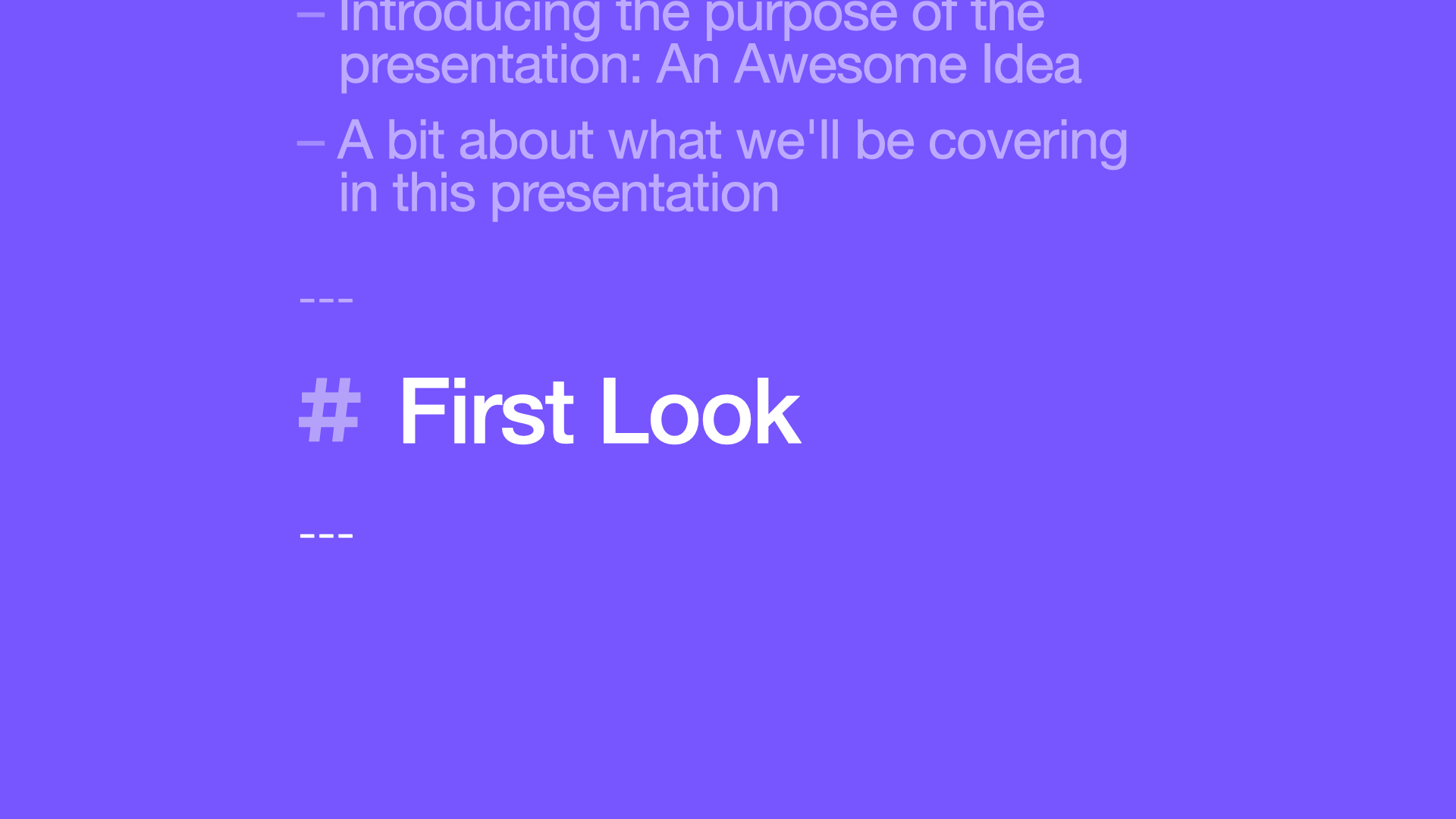

A Section Title slide in Markdown
And remember: you can change that to an H1 Title to make it a "Section" divider.

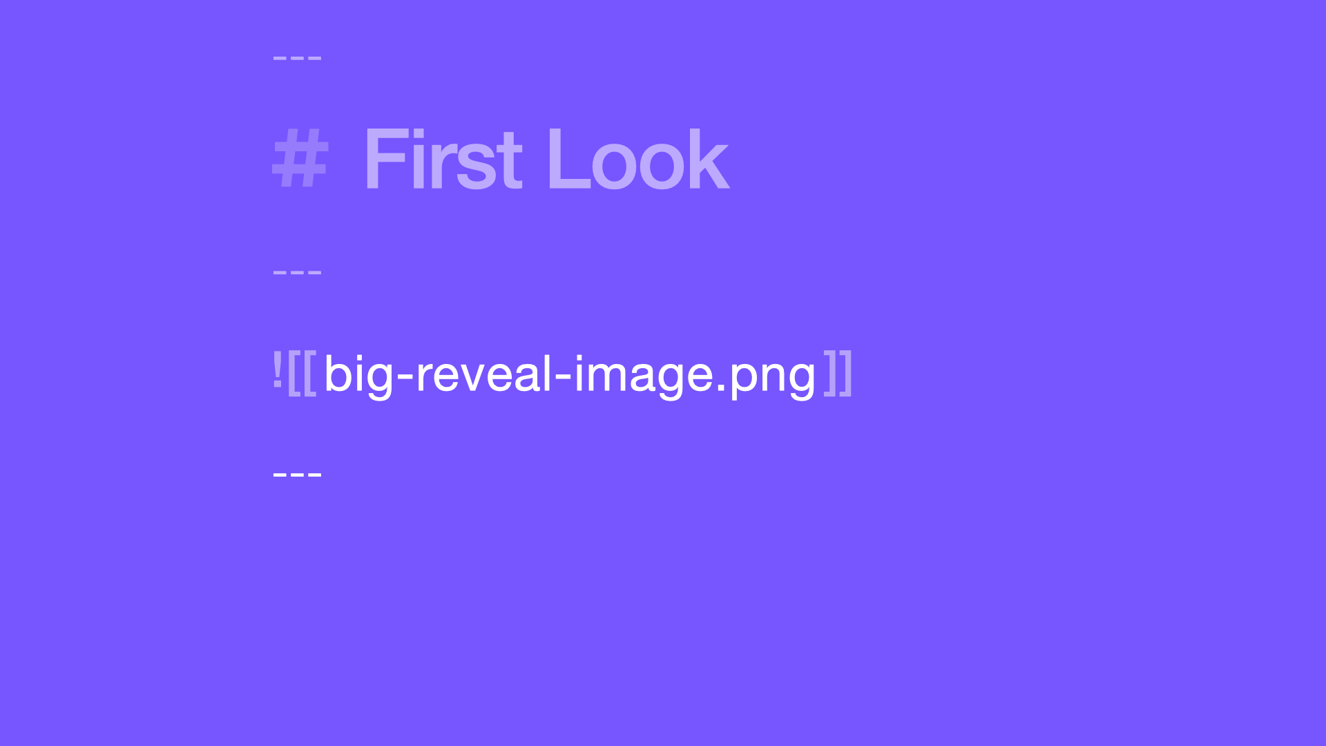

A basic Photo slide in Markdown, Local image style
When you're ready to add an image to your show, you can do it a few different ways. Local images – images that are located on your computer – are indicated with an Exclamation Point and two square brackets. Add the file name from Finder, and close the brackets. If we close the slide here, we're building a basic "Photo" layout.
At present, all Local Images used in a show need to reside in a single, common Assets folder: if Local Images are indicated, the Build Script that Composer outputs will prompt you for that folder before it builds the show.

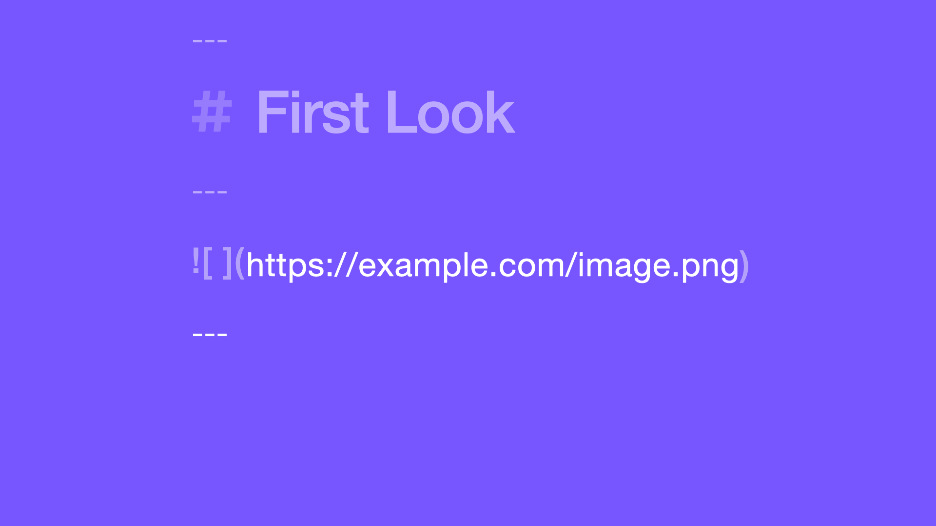

A basic Photo slide in Markdown, Remote (web) image style
If you want to add a Remote image – directly from the web – use a slightly different syntax: use an exclamation point and a single set of brackets, then a parenthesis to hold the web address.

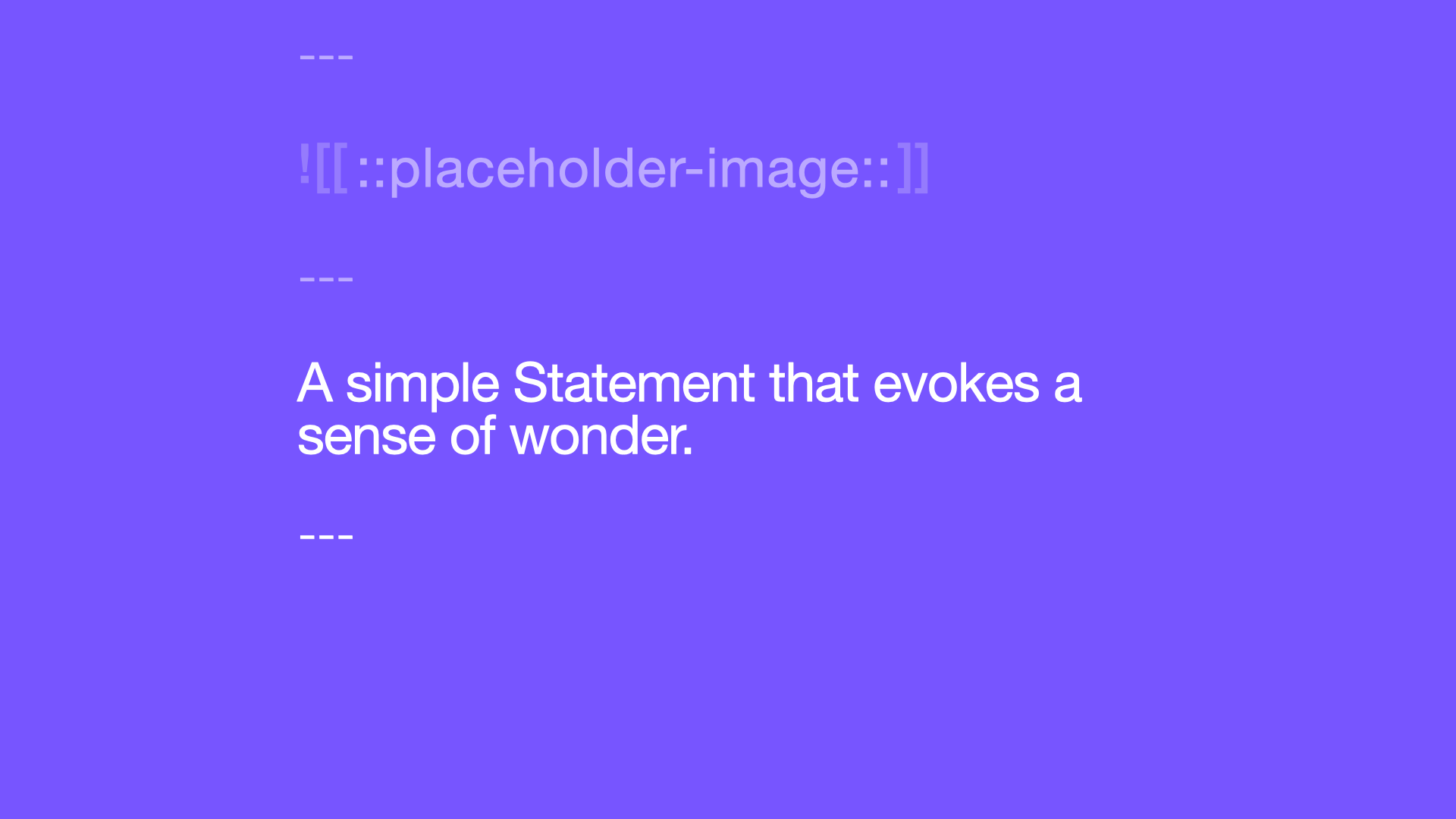

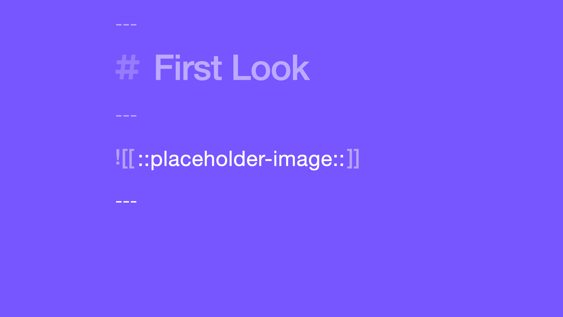

A basic Photo slide in Markdown, using a Placeholder Image tag
Or – if you want to add an image to a layout, but you aren't sure which one you want to use yet – you can use a local-style image wrapper around a Placeholder Image tag to include the theme's default image: that'll ensure a placeholder's ready and waiting for you once you get to Keynote.

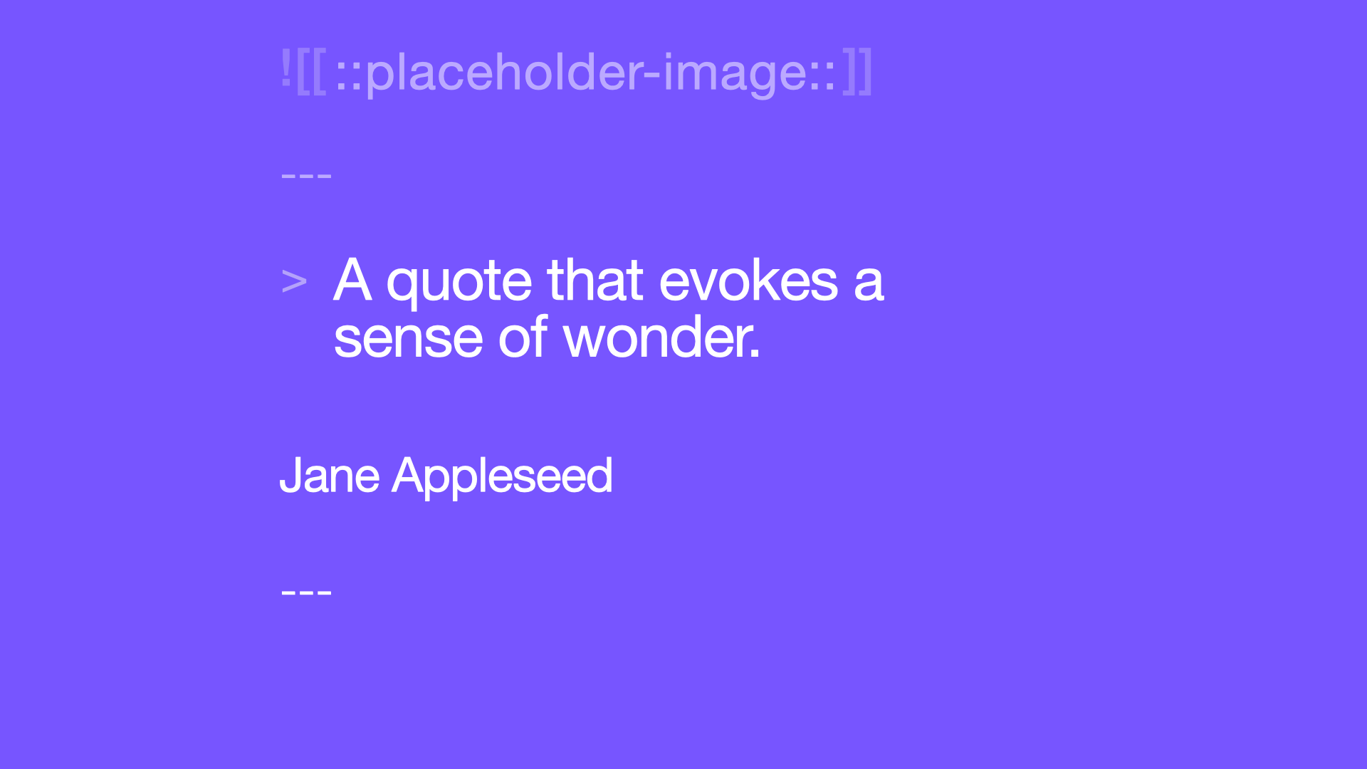

A basic Quote slide in Markdown
To build a "Quote" slide, type a Right Angle Bracket and a space before your quotation, then follow with a plain Paragraph element containing the attribution.
A basic Statement slide in Markdown
Or, if you just want to make a simple "Statement" slide, use a basic paragraph all by itself.

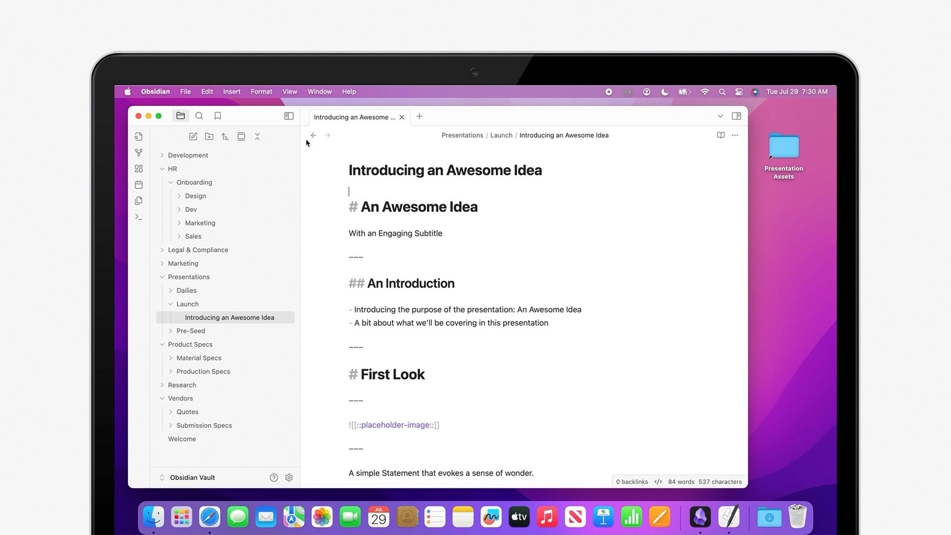

A Markdown-formatted presentation in the Obsidian app on Mac
On your Mac, apps like Ulysses and Obsidian are specially-made for writing this way, and make it easy to edit and organize your presentations right alongside all your other notes.
In Obsidian, you can toggle between "Reading View" and "Source Mode" to see the Markdown source for any of your documents: type "Command-E" - or click the View Icon - to toggle between reading and edit modes. Be sure "Source Mode" is enabled in the View Menu to view the plain Markdown source.
And since it's made for Markdown, you can let the app handle the formatting basics for you when you drag in image assets from your Obsidian Vault: this makes image integration a breeze.
If you're using this technique, we recommend pre-staging your imagery into a dedicated folder in your Obsidian Vault: Obsidian will create a local reference copy of images you drag in from elsewhere on your system, which can create unwanted duplicates.

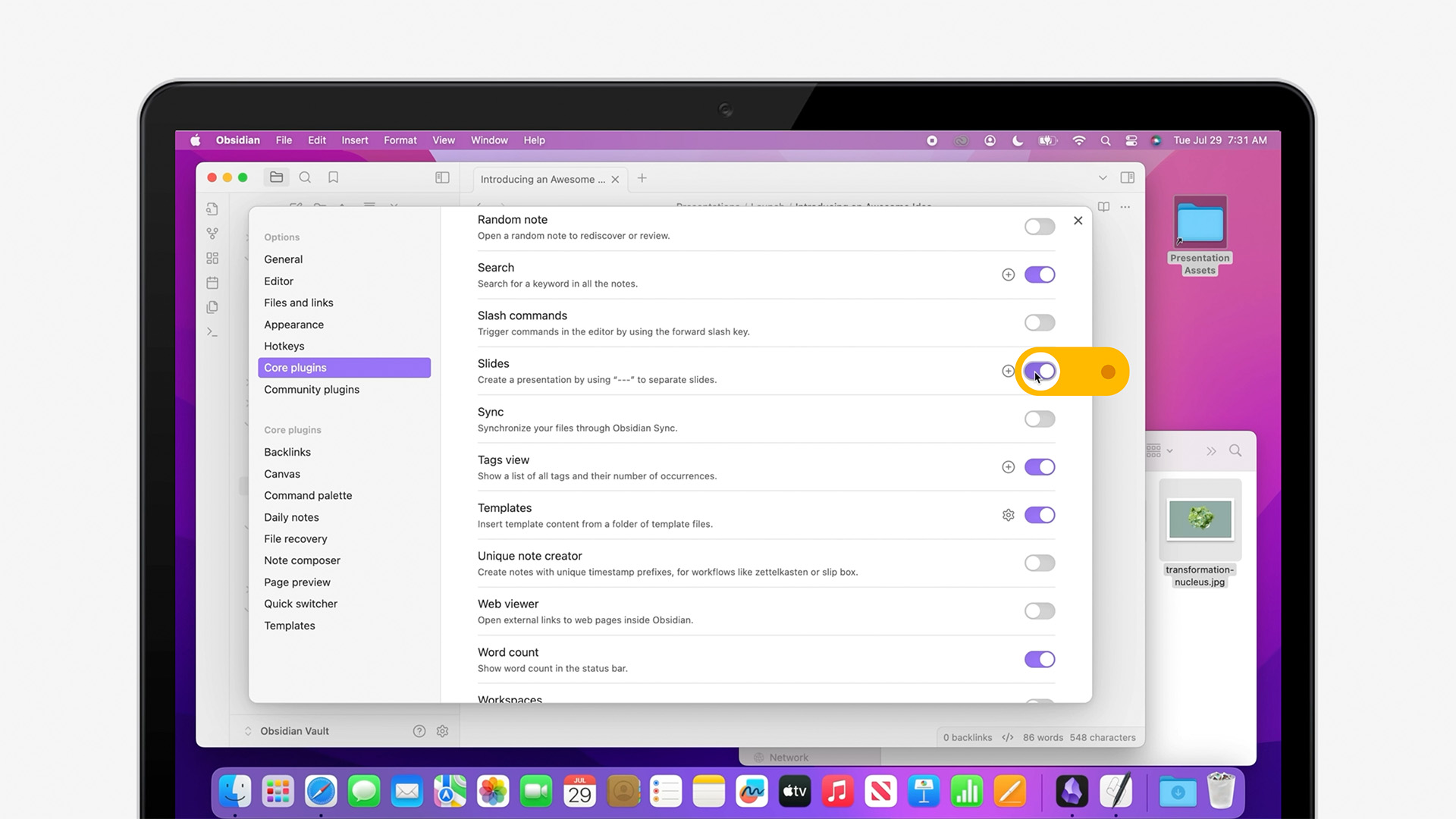

Enabling the Slides pugin in the Obsidian app on Mac
Obsidian even includes a rudimentary Presentation Mode, so you can get a rough idea of how each slide is shaping up as you go. To enable the Slides plugin, open the Settings from the App's menu, and select "Core Plugins": scroll down to "Slides" and toggle it to active.
Once enabled, you can Right-click or Command-click a presentation document and select "Start Presentation" to switch modes. Hit Escape - or click the mode-level Exit Button - to close Presentation Mode and return to editing.

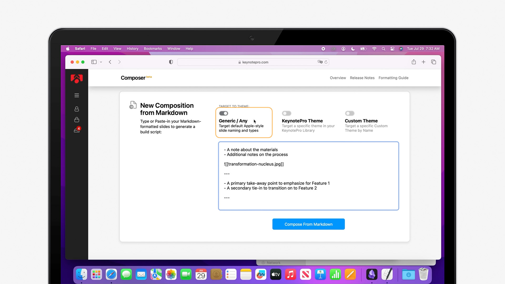

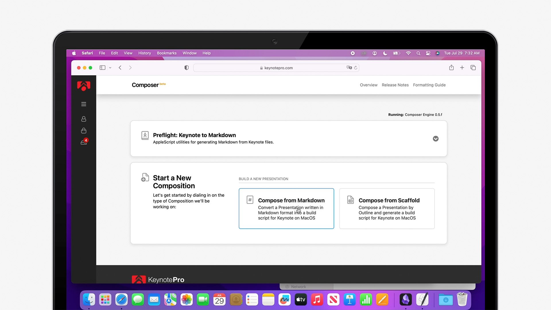

Selecting the Compose from Markdown Pathway in the composer web UI
Whenever you're ready to transition to Keynote, select the Markdown source for your show and Copy it to your clipboard. In your browser, bring up Composer and select the Compose from Markdown pathway.
Markdown is pasted in, Generic Theme Targeting is left checked
Paste your Markdown into the input field: we're going to leave the Output Targeting set to Generic for now, and choose a theme later. Click the "Compose from Markdown" button to generate a build script.

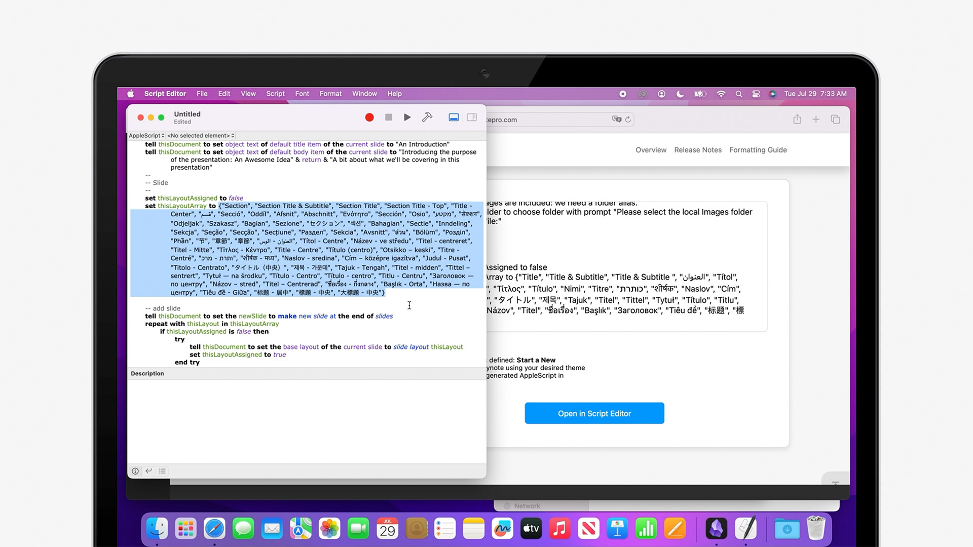

Composer generates a Build Script using AppleScript to run on your Mac
Composer parses your Markdown and – almost instantly – writes out a fully-customized AppleScript routine to build your show in Keynote, ready to run in Script Editor.
Click "Open in Script Editor," and confirm that you want the handoff to proceed: this will open the script in Mac's Script Editor application, we you can review or edit the output.
A compiled Composer Build Script in the Script Editor application on Mac
In Script Editor, Click the Compile Button to validate the script, which will make it a bit easier to read. Since we're building an entire presentation, the script includes a complete set of step-by-step build instructions for Keynote, including all of the content from your Markdown file.
Highlighting the Global-aware Layout Names for the Section Divider route
Composer knows what layouts are called in every language Keynote supports – even the names that might be used in some older themes. So we can run this build using any theme that follows Keynote's standard naming conventions, no matter which language you're using.

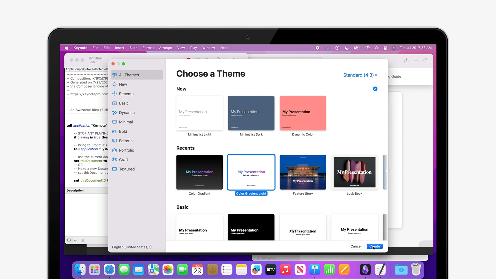

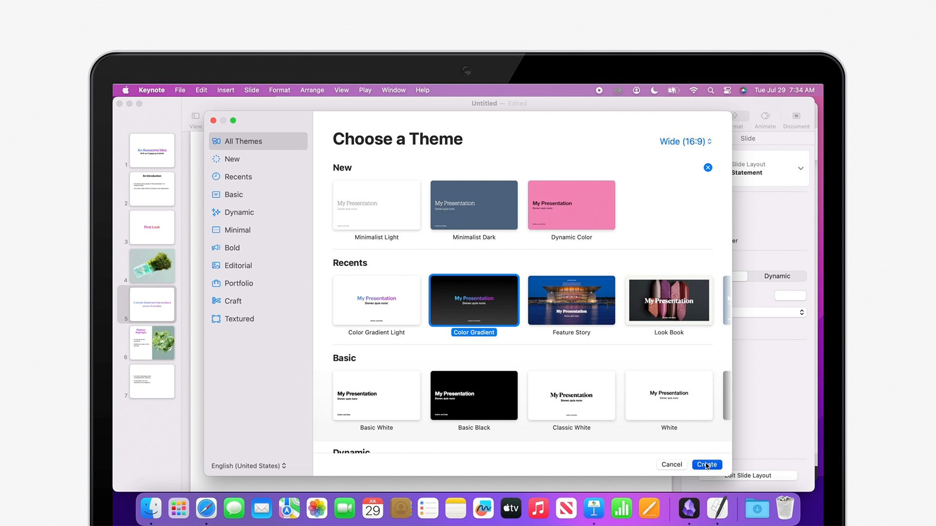

Select a theme in Keynote to set up a Build Target
Before we click Play to run the script, we need to create a starting point in Keynote for the build. You can choose any of the built-in Themes or Custom Themes installed on your Mac, in any size you want: that's one of the advantages of separating idea from execution this way. For now, let's keep it simple and go for the Light Color Gradient theme, in Standard 4:3 format.

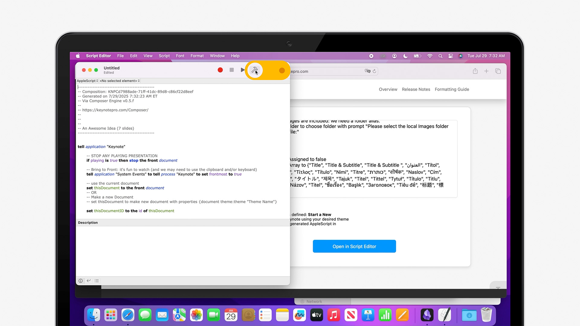

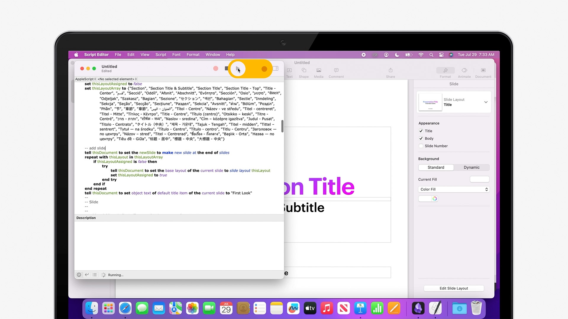

Click the Play icon to run the Build Script
Now that we have a build target, we're ready to run the Build Script. Switch back over to Script Editor, and click the play button on your Composer Script to start the build.

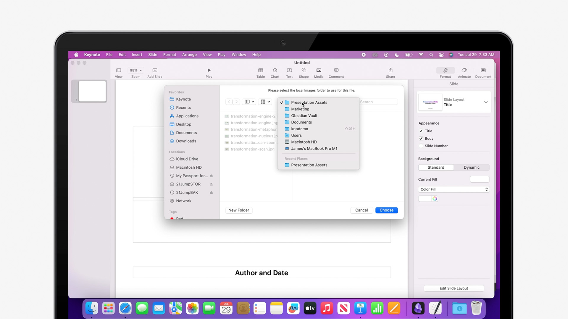

We're first prompted to choose the local images folder to use for image references
Since we're using local images, we're also prompted for the folder we should use: select the same folder we were using before in Obsidian, and click Choose.

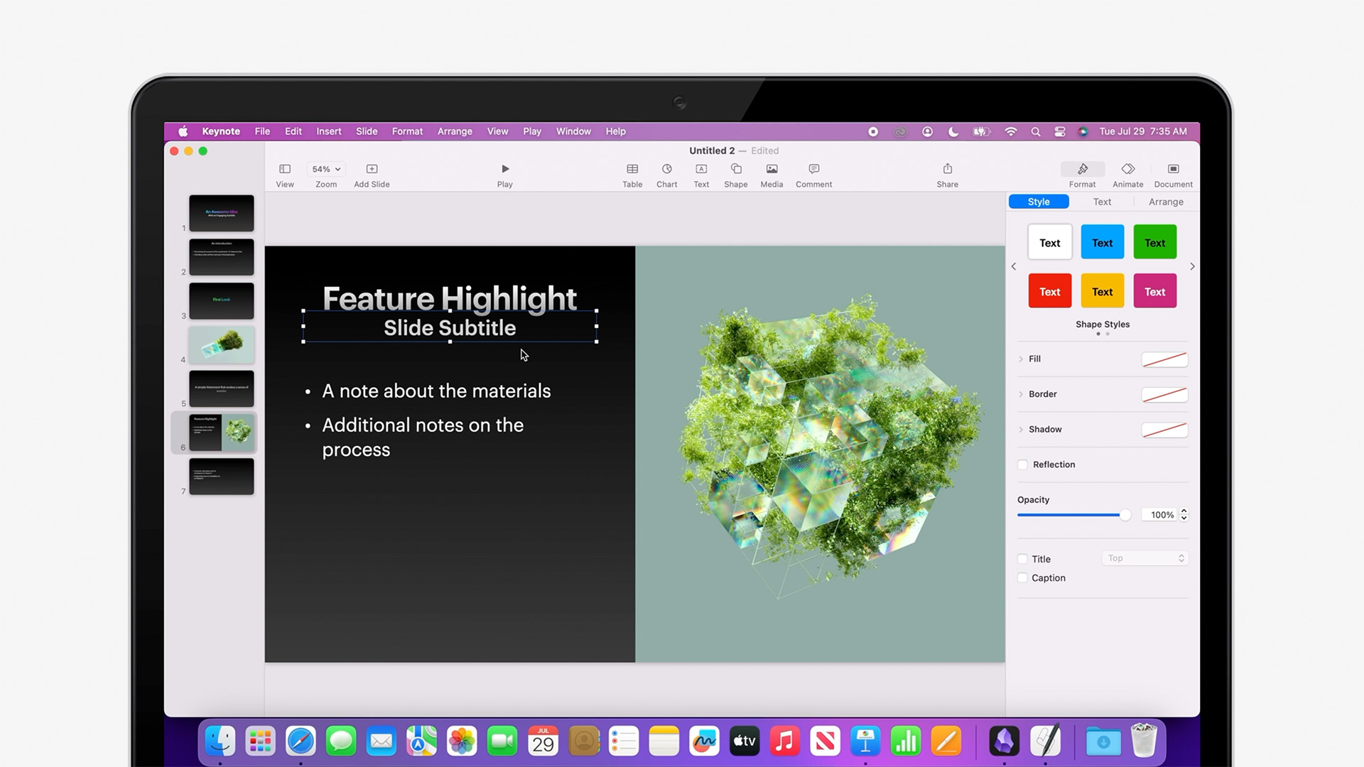

An example of a theme that includes slide-level Subtitle
If you're targeting a theme like this one, for instance, that includes Slide-level Subtitles under the Main Title, you can add those directly into your Markdown script.

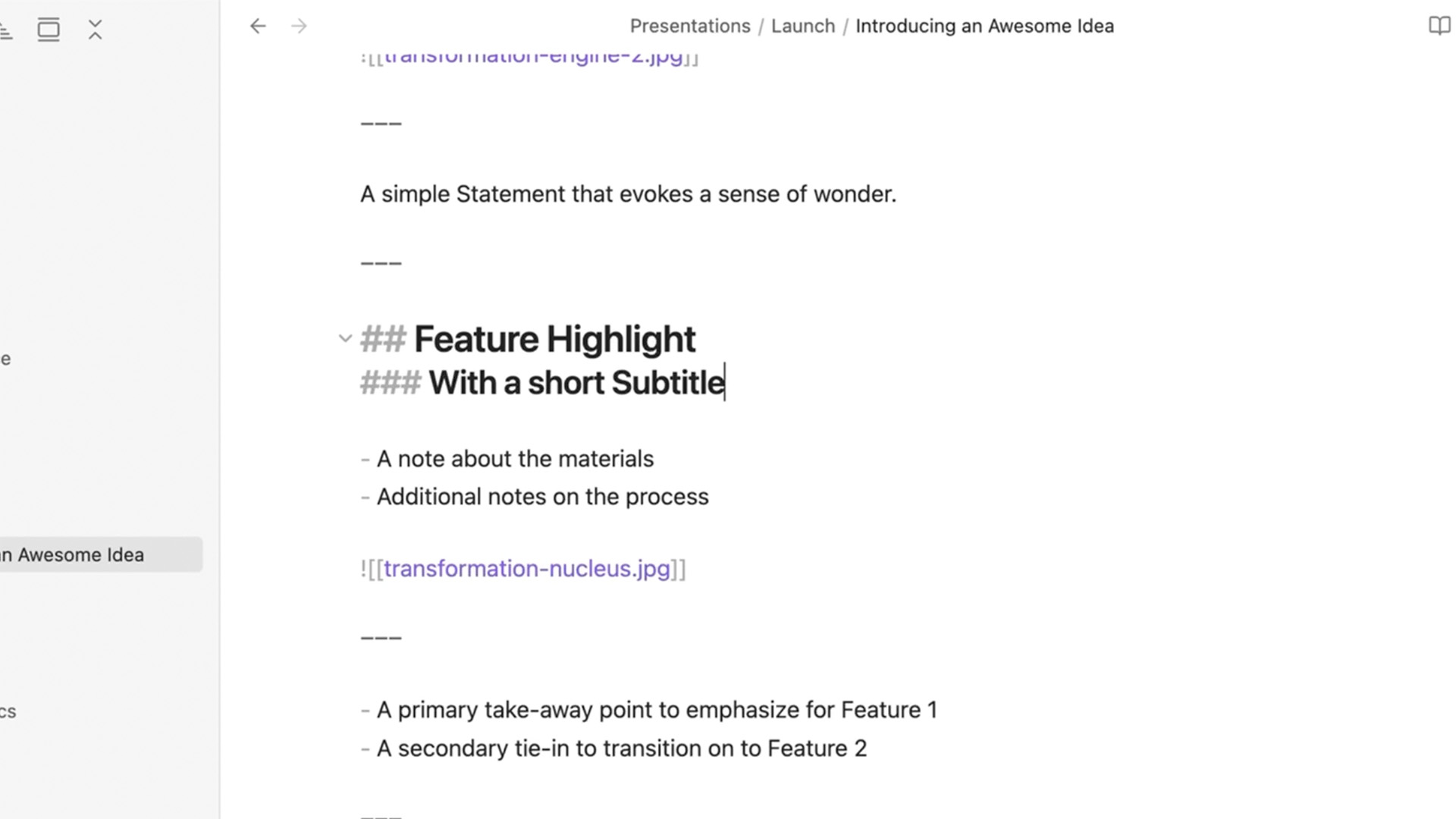

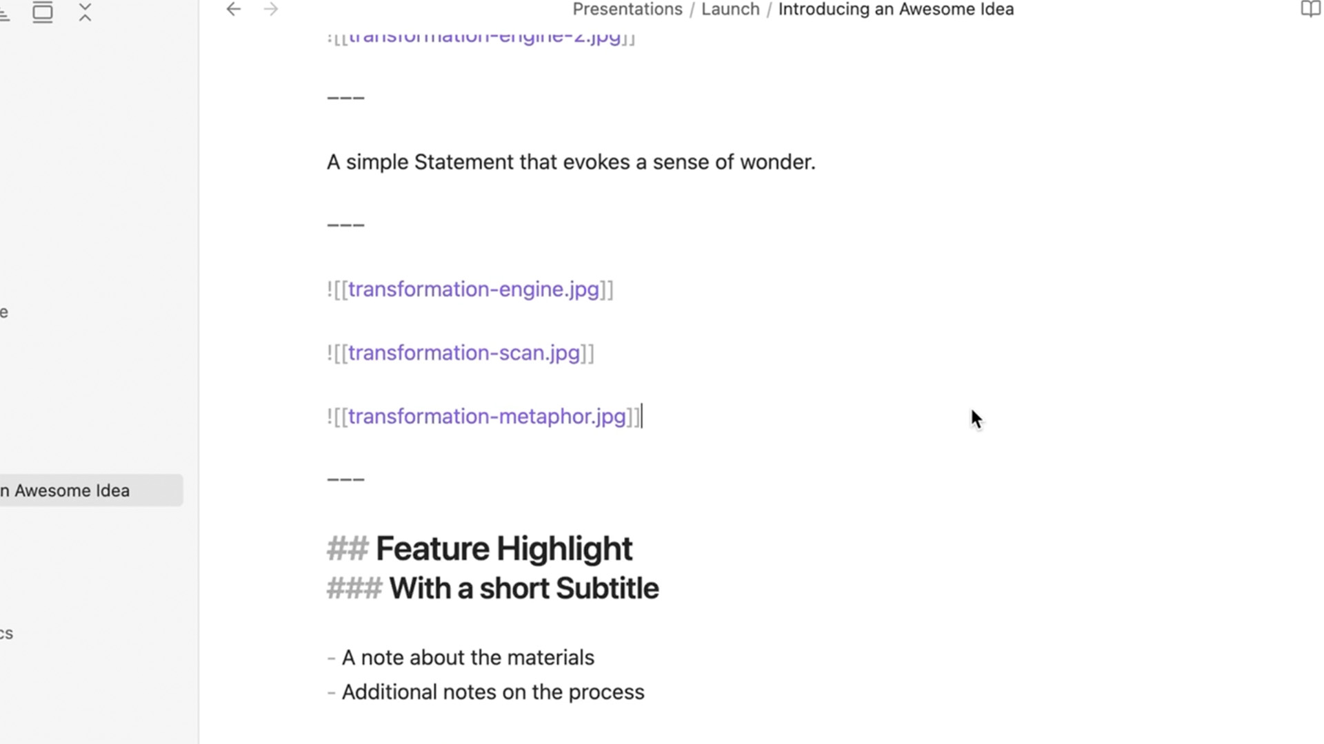

Adding an H3 title below the H2 to target the Subtitle
Use an H3 title – with three hash marks – directly after the slide title to target these sorts of Subtitles on your Content slides.
Adding a Photo - 3-Up layout in Markdown format in Obsidian on Mac
Speaking of three – let's also add a "Photo - 3 Up" layout here before we move into the Highlight slides.

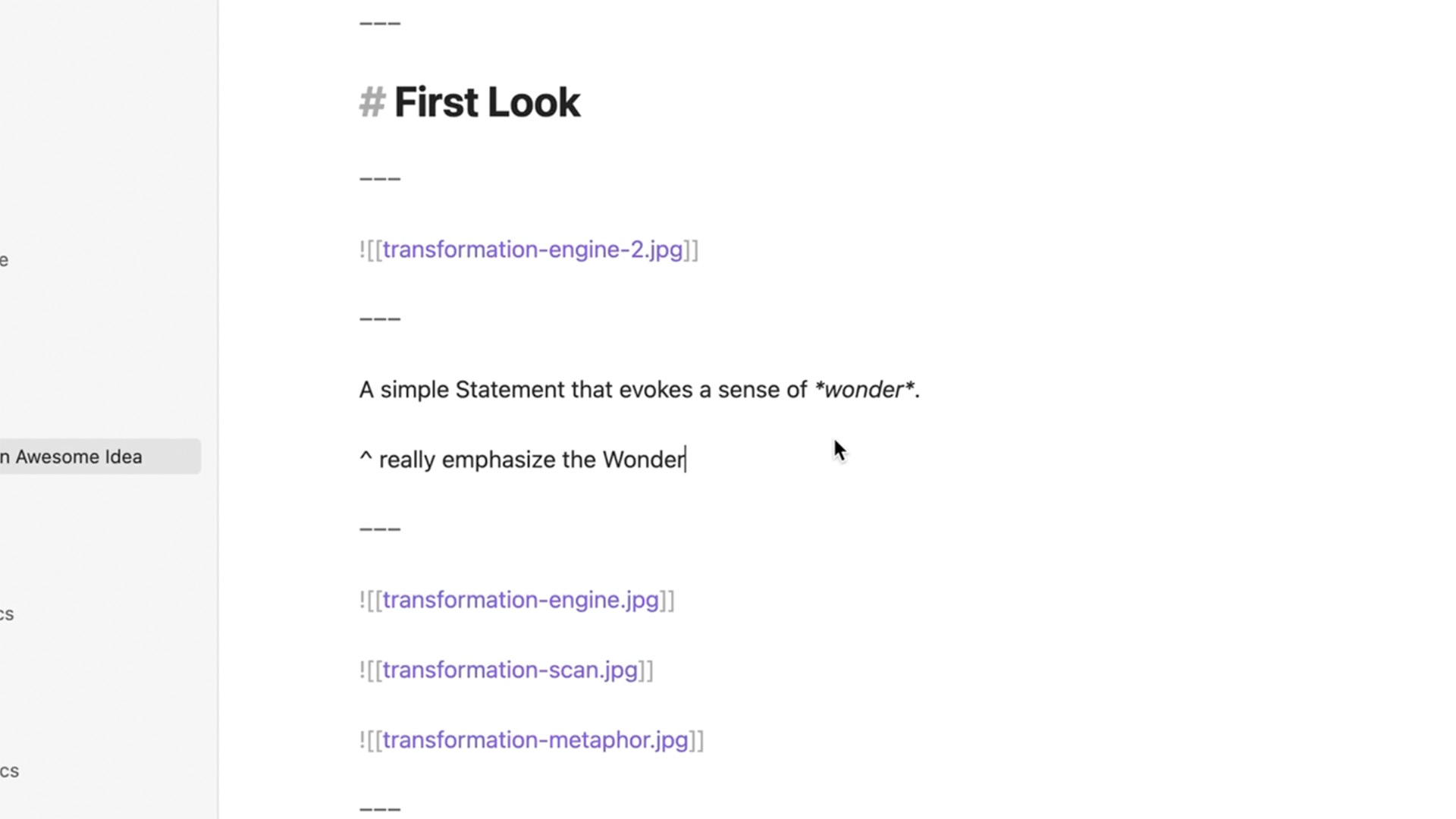

Let's also add a bit of Emphasis to our Statement slide. You can Italicize text in Markdown by wrapping text with a single asterisk. Bolds use two asterisks, and Bold Italic is all 3 asterisks together.
Adding Presenter Notes in Markdown on the Statement Slide
And we can add Presenter Notes right into the show's script as we go: add a new line starting with a Caret symbol and a space before your note whenever you'd like to include them on a slide.

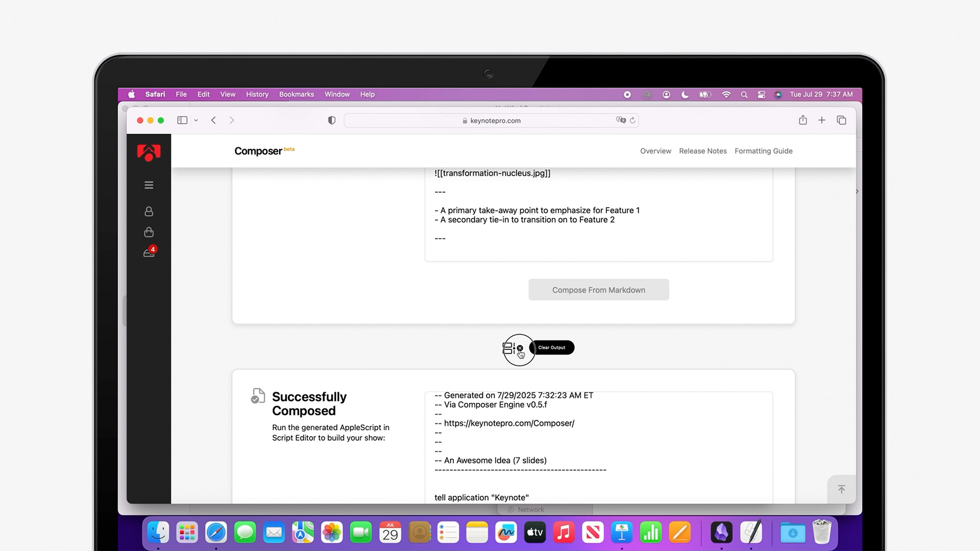

Clear the original Composer output to re-compose.
Whenever you're ready to move back to Keynote, we just repeat the process from before: copy the updated script to the clipboard. Back in Composer, dismiss the old build by clicking the "Clear Output" button above the old response.
Re-Compose the Build Script with the revised Markdown.
Delete the old markdown, and paste in the revised script. Then, re-compose with our changes.

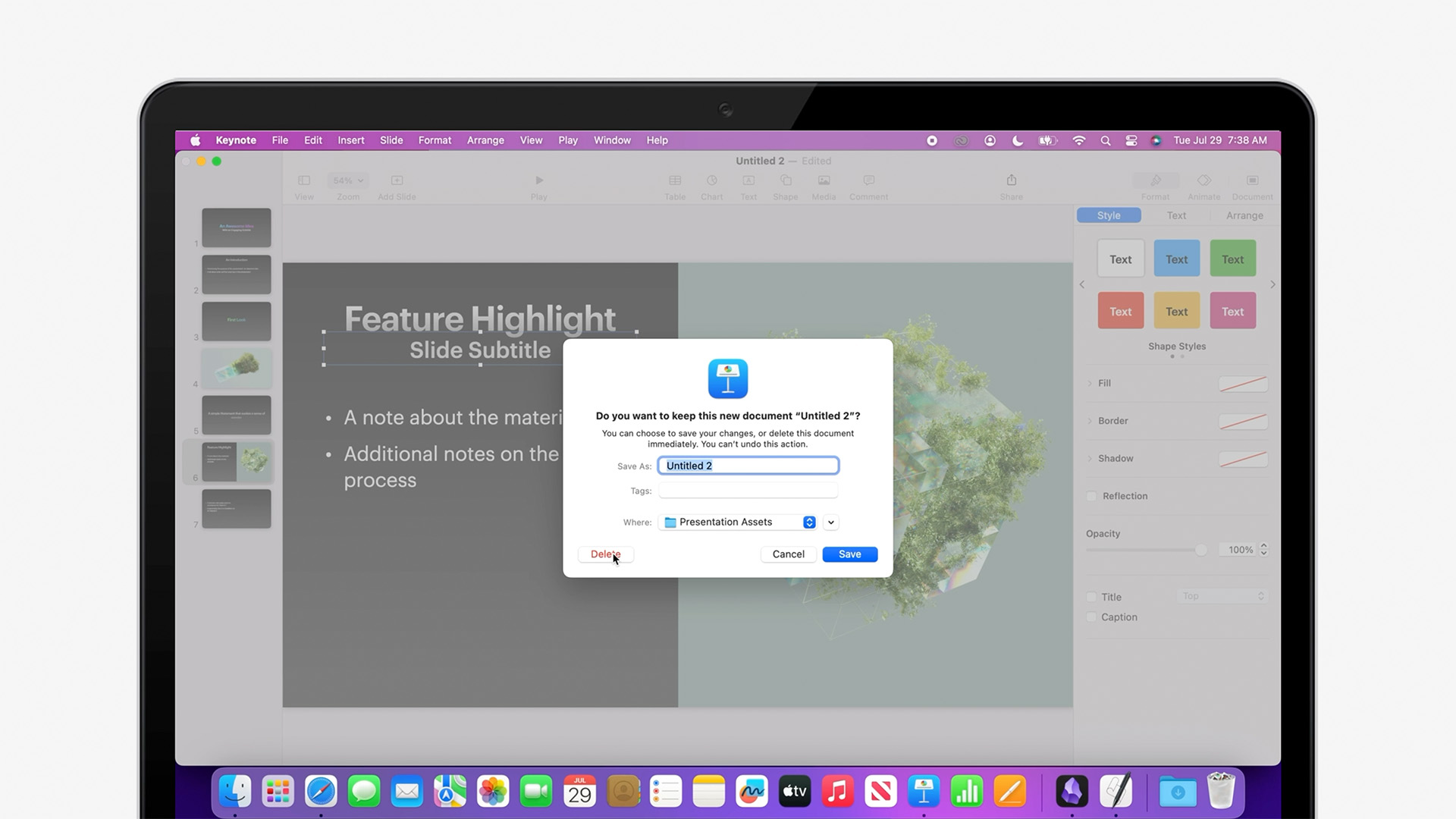

Discard the old Keynote files before running a new build.
Keynote side, we can discard the old build completely: the "Build a New Presentation" pathway generates entire shows from scratch, so we'll need to create a new starting point for the new build.
